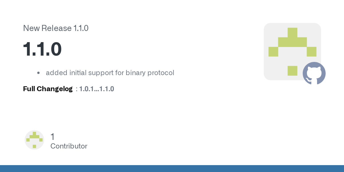

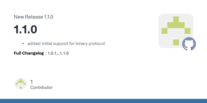

I added support for binary protocol to my library and component.

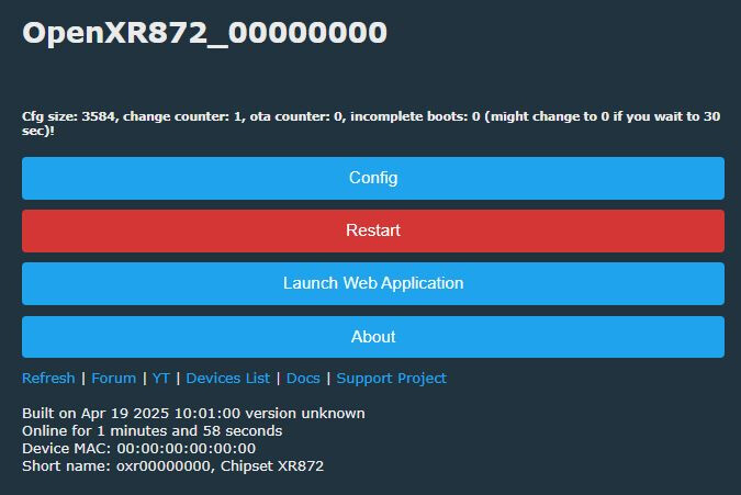

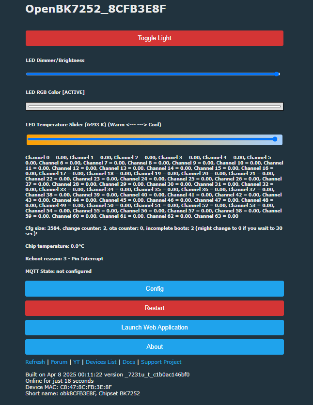

Some recent developments regarding BK7252 and XF16 devices and open-source firmware alternatives in these two Elektroda threads. Early builds of OpenXR872 (XF16 boots with app built from XR872 SDK) and OpenBK7252 shown running on A9 cams.
No camera support at this stage and most things don’t work, but here if anyone’s interested:
https://www.elektroda.com/rtvforum/topic4074636.html
https://www.elektroda.com/rtvforum/topic4073760.html

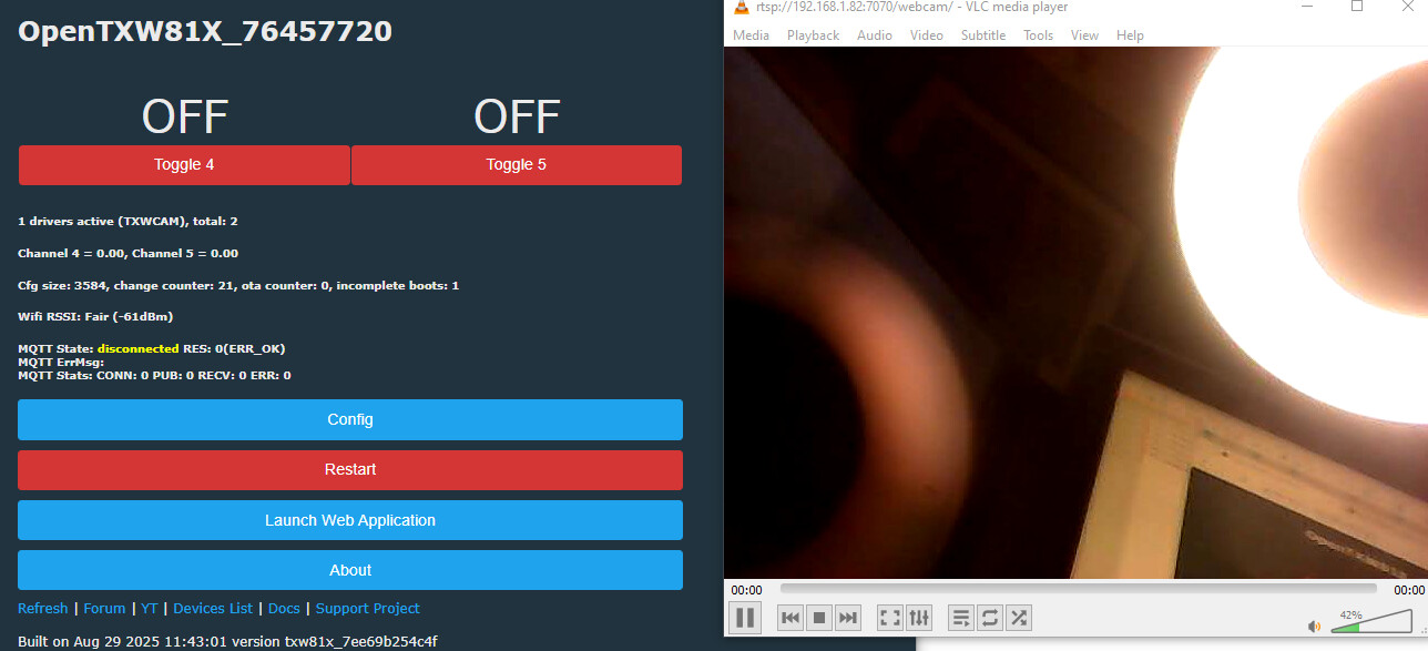

OpenTXW81X in development
development thread: https://www.elektroda.com/rtvforum/topic4033757.html
development for OpenTXW81X heats up from: https://www.elektroda.com/rtvforum/viewtopic.php?p=21638429#21638429
