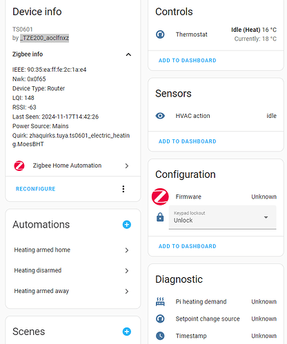

Thanks in advance , I have possibly a similar issue, using ZHA i dont see many entities the quirk seems to be loaded correctly but i dont see any additional entities. maybe temperature and state are what i should only see.
no way to change dead zone or adjust clock.
Also is it possible to deactivate the temperature sensor and use this only as a switch as i want to use secondary temp sensors.
i have one BHT-006GBZB Moes Room Thermostat device.

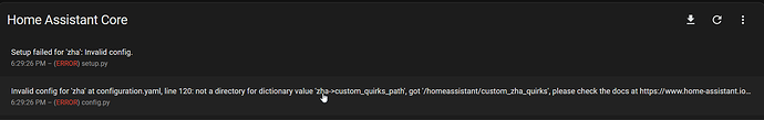

i tried the soluction as per post #12 from @slickers , but am getting the follwoing:
Logger: homeassistant.config
Source: config.py:1335
First occurred: 11:26:09 AM (1 occurrences)
Last logged: 11:26:09 AM
Invalid config for 'zha' at configuration.yaml, line 94: not a directory for dictionary value 'zha->custom_quirks_path', got '/config/custom_zha_quirks/', please check the docs at https://www.home-assistant.io/integrations/zha

Did you use this file name because it’s the same as the quirk in your device already? My device was previously paired to a SmartLife hub and has the quirk name shown below. I’ve tried naming the file as you suggest and also to match the existing quirk name but nothing seems to happen. Do you know if I need to change anything in the quirk file since the device _TZE200_aoclfnxz is slightly different to yours? How many entities are exposed when it works correctly - do you have more than what is shown below? Thanks and sorry for all the questions!

Hello, I have the same problem with the thermostat ZHT-006 and I installed the mentioned quirk, however it is not working for me. I cannot see the quirk installed at the bottom of the zigbee info for this device. I tried to reconfigure, restart and even re-pairing several times with no results. I don’t know if I can use any name for the file xxx.py and how this file is linked to that specific device. Can someone help me with that ? Thanks
It doesn’t work for me.
I put the custom_zha_quirks directory on the same level as my configuration.yaml file and then uploaded the ‘ts0601_trv_moes’ quirk file in that directory.
In configuration.yaml file I added the following:
Zigbee Moes Thermostat
zha:
custom_quirks_path: /homeassistant/custom_zha_quirks/
I tried with and without '/homeassistant/ in the path but it still doesn’t work

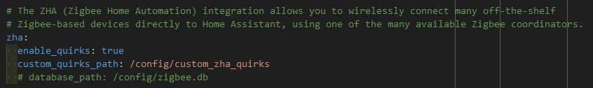

I believe there might be an issue with the way the tabs are aligned in your code. Here’s my screenshot for reference:
Let me know if you need any clarification! :blush:
