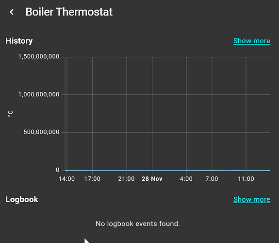

I’ve got mine working using the link but I see massive spikes every now and again on the target temperature (which I haven’t figure out yet…)
Thanks! Yeah a lot of the reading I’ve done seems to suggest ways of coding around this, none of which are apparently perfect. I’m not a coder so am very wary of going down that route unless it’s absolutely necessary, especially for a device I’m almost sure there must already be support for. Device prevalence/popularity is hard to be 100% positive about though (I don’t have device sales figures, so my assertions may be totally wrong).

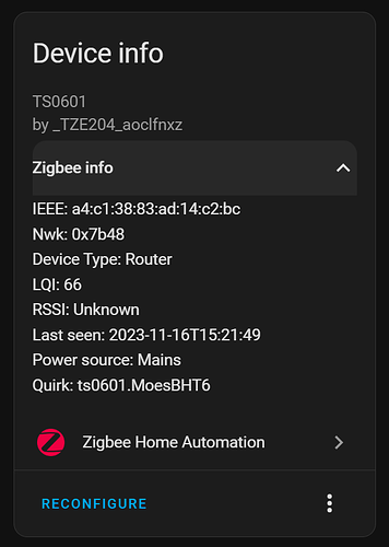

The Device Info card in your screenshot suggests that no “quirk” has been applied. It would normally appear at the bottom just above the Zigbee logo:
This is the case even when the quirk has been built in to ZHA - I’m sure yours will be eventually, but there are quite a lot of them, and new ones being requested all the time. In the meantime you need to add it as a custom quirk. Looks like @slickers has found one, so there’s no need to request another.

Hmm, I don’t see Quirk in any of my ZHA devices in the Zigbee Info section?
Is it a dev tools thing?
No. Presumably all your other devices work without one.
Here’s what mine looks like. Am I allowed to drop the file in here?

I also seem to be having the same problem with the same brand of thermostat. I added the custom quirk and i think it has been read cause HA created a new dir in my custom_quirks folder, but the quirk doesn’t seem to be loaded/linked to the thermostat. What shoul i do?
image_2023-11-19_153949461
Hi everyone,
Thanks again for all the support with this.
I added the quirk that slickers posted above and it did indeed unlock the hvac and temperature entities (see screenshots). However, having recently added a custom quirk for some radiator valves which exposed something like 10 different entities, I’m pretty sure this custom quirk hasn’t exposed anywhere like the full list of things that should be supported.

I thought I’d also just share that there’s clearly something wrong with the temperature setting too lol:
Or maybe it’s just the scale of the graph showing in HA?
I’m also seeing those spikes!
Haven’t figured that bit out yet. Deosn’t appear to make much difference to the target temperature but it does make my graphs look rubish.
