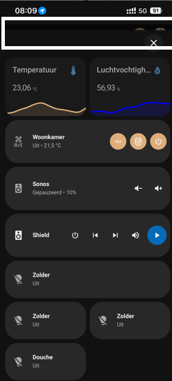

Wow, this already looks amazing, thank you!
There are just three things I’d love to adjust:
  1. It would be great if it could be displayed a bit higher (see screenshot).
  2. On my phone it’s a bit buggy — I can’t control the entities.
  3. Could you add an option to trigger an action when pressing the close button? That way I could open another popup and stack multiple popups (sort of a “back” function).
    have you tried setting max height to 100? and top alignment?

I also tried 100 and top allignment. But then the same problem appairs on the bottom.
But the biggest issue atm is that i cant use any entity when on popup. Doesnt respond.

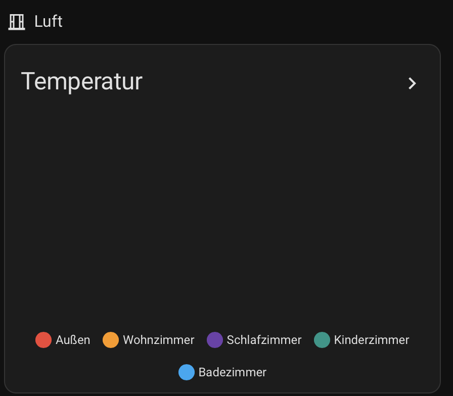

one bug i found if a history-graph card is in the popup the graph is empty
