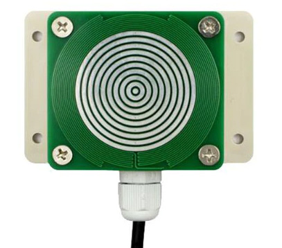

Here a heated rain sensor with relay output, it needs a power supply and it will start to heat below 15°C
rain_sensor02
You can find more information on sellers page at Aliexpress:
Like I said before, is there someone who used one of these heated ones? I like to know if it’s giving reliable information.
