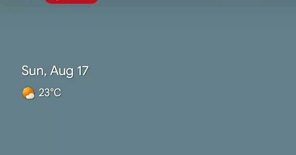

This script should then clear all three notifications. However, one notification always remains on the notification panel. I’ve posted a video which shows the behavior.
I really wonder if someone experiences the same issue. It’s pretty annoying…
Video
