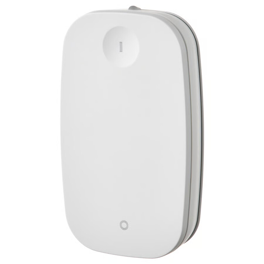

A physical device like this:

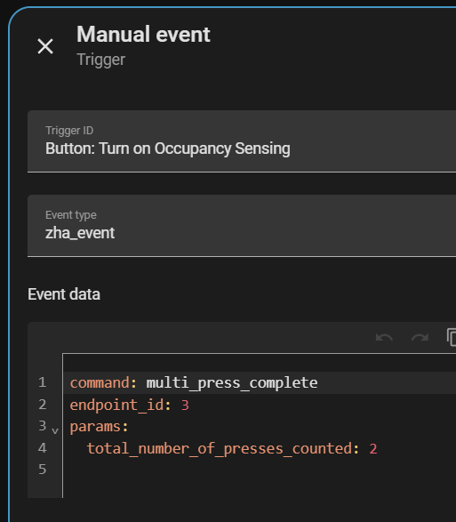

I was watching the zha_event the other day and looking at how I might handle this:
For IKEA buttons, it’s insane. There’s endpoint_id and cluster_id and other things related to args that are all wonky for their more complex buttons.
Inovelli wall switches were a lot easier:
event_type: zha_event
  command: button_2_double
If this really is the way, I guess I’ll have to do it. Not excited about it considering how hacky it is to set up, but I guess that’s all I can do.

Please post these events. Secondly, the new triggers and conditions that are getting rolled out can use labels.
But ZHA doesn’t currently provide event entities for button devices, so there’s nowhere to apply the Labels in a way that the new triggers can be leveraged.
Can you provide an example of a zigbee event like he’s describing here?
At this rate it’s going to be 10 days before any examples can be provided.
I don’t have any of the IKEA multi button devices. But, I think the picture he posted the other day was of the Rodret which, based on @censay’s blueprint, means the trigger options should be:

You were similar. I have RODRET buttons, but that one posted was from a SYMPHONIK media button.
