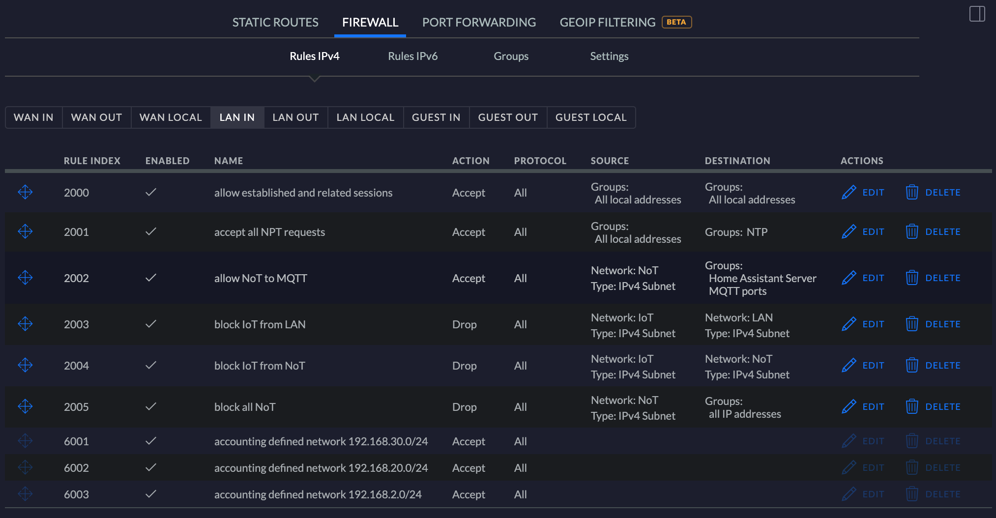

Thanks for the advice. Will try and figure out how to make the right firewall rule between HA (mainWifi) and Yeelight(NoTwifi).
I though because of this tutorial â https://www.youtube.com/watch?v=p3SfeQTaaxw â that perhaps the yeelight would already be able to talk to HA because of either the âallow established and related sessionsâ or âallow NoT to MQTTâ.
2nd thing - is the above code ok for connecting to the IP assuming the firewall devices are setup?
Or do i need to modify the IP address or something to use the subnet address - ie instead of 192.168.30.124: using something like 192.168.30.124/24
One the device is connected and it can talk i guess I need some way to connect and check the device is working - so was thinking from other videos it would show in Entities.
