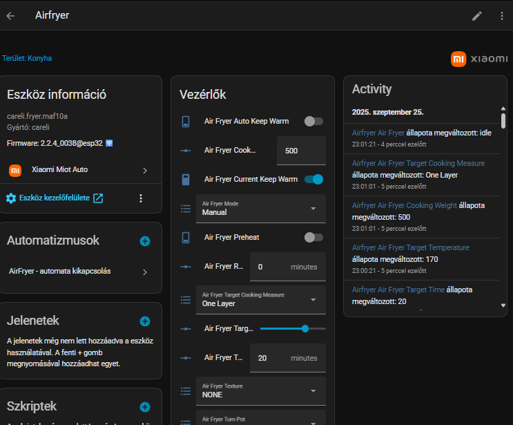

I use the Xiaomi Miot Auto HACS plugin for all my Xiaomi devices. It usually works well with everything and offers the most features.
