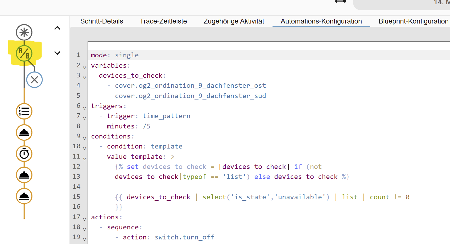

I put this in Development Tools/ templates:
{{ ['cover.og2_ordination_9_dachfenster_sud', 'cover.og2_ordination_9_dachfenster_ost'] | select('is_state','unavailable') | list | count != 0 }}
and I set the state with Development Tools/States.
The output didn't change.
Whats wrong now?
Testing the template that way is working for me. Are you sure you used the correct entity ID and spelled the state correctly... those would be the most likely causes. Also, try refreshing your browser just to be sure it's not a caching issue.
Its quite strange, normally the color of the condition looks different.
And yes, I checked everything more than twice ....
Are you manually triggering the automation...? That skips both the trigger and conditions, which would explain a lot, including the lack of color in the Trace.

If that's what you have been doing, ever since you removed the single-quotes, then you have been testing it incorrectly.
Your original Template Condition was fine (longer than necessary but fine). The single-quotes were wrong. They converted the variable named velux_devices into a string. That means the variable devices_to_check was not assigned the correct value (and the Template Condition would fail).
... I triggereed manually .... after waiting for the real trigger (every 5 minutes) it works out.
