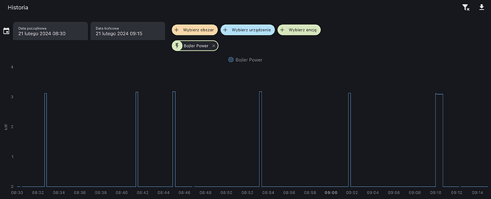

I’ve run into the same problem. Unfortunately, due to the nature of my device (an electric water heater) which runs in short bursts of power, there’s a big difference between HA and the Tuya app (Tuya reports 42kWh, HA only 24kWh).
Here’s a screenshot from my history - the longer peak at the end is with the Tuya app open on my phone.
Has anyone tried to play around with the Tuya Energy Consumption API (Query Energy Consumption Trend-Cloud Services API Reference-Tuya Developer)? Maybe we could add a REST sensor to HA that would periodically read the real values from Tuya Cloud?
// Edit
I have followed this advice (Tuya energy monitoring only updating when app is open? - #23 by matt3003) and changed the scan interval to 1s - everything seems to be working real-time now.
I don’t think that 1s is needed for devices with a power draw that’s approximately constant, but for my case it makes sense.
