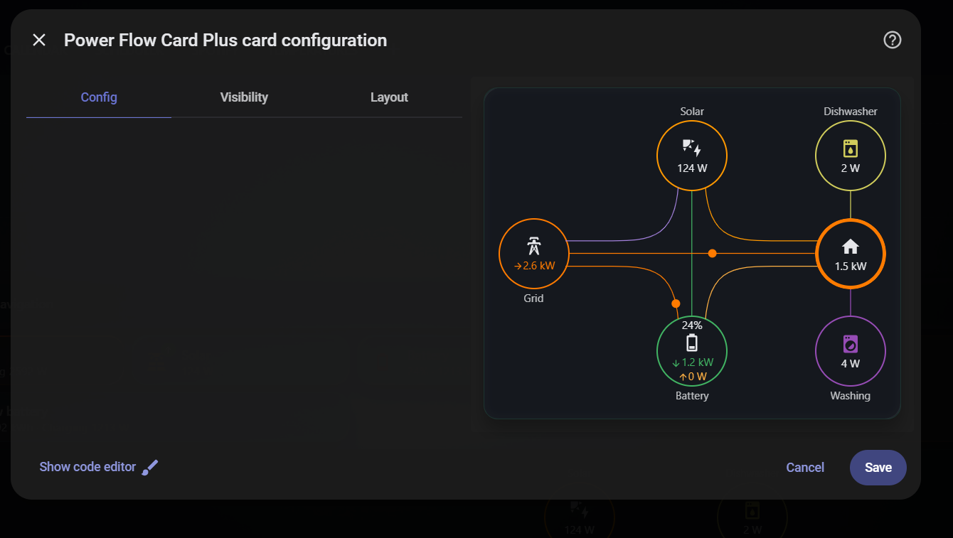

Hi All,
Not sure if this has been mentioned before but can’t find anything. For some reason i can’t see the config part of the card when i edit it?
Any ideas?

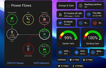

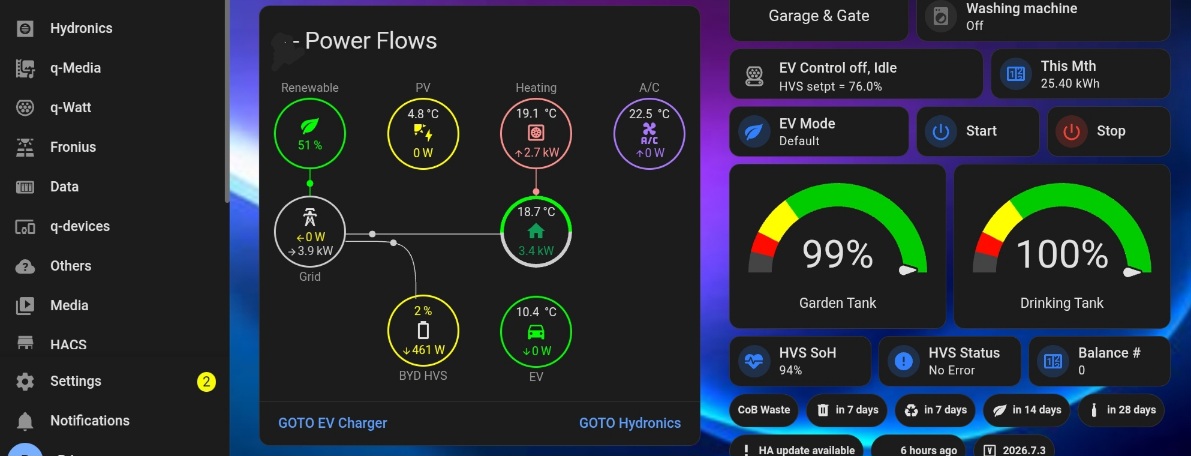

This is not limited just to the edit pane. I added a third individual device (air-con) to my existing card and, on a landscape tablet, it looks great (& works as expected). However, if I rotate to portrait, the third device is truncated. The same occurs on my phone (truncated in both portrait & landscape).
By default, I’m using the Sections layout. Masonary & Sidebar behave in the same way. However, Panel layout shows the whole card (including the 3rd device) on the tablet & the phone in both portrait & landscape - but it’s very squashed on the phone in portrait.
Panel layout is not very useful as it’s limited to a single card!
I assume there is a scaling limitation preventing the card from reducing enough to include the 3rd individual device. Is this fixable?
BTW, thank you for this exceptionally useful card. We’ve been using it daily since you published it :slightly_smiling_face:

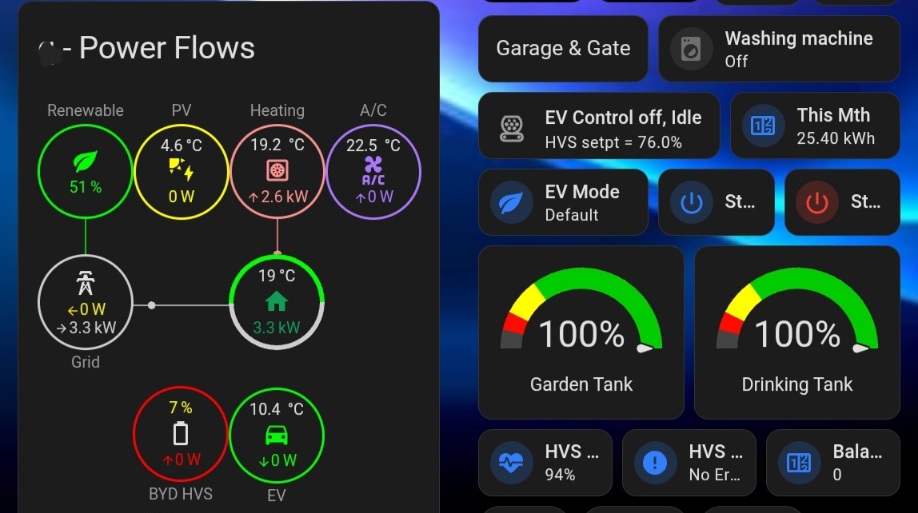

Truncated
Not truncated
Ok, answer my own question. Set allow_layout_break to true.
This allows 4 individual devices to show even when there’s not enough room.
With allow_layout_break = true

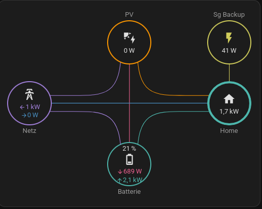

… I have a hybrid sungrow inverter wit a pylontech batterie and an extra home made battery with a daly bms and self templated entities for charging an discharging.
I combine the charging and discharging entities in my template.yaml and added batterie values for power flow card plus. as a result that the home value is also somehow counting the values which is wrong in my instance… how can i get a correct home value when my self made batterie is charged?
Why do you don’t use the separate entities for charging and discharging in Power Flow Card Plus? You have the opportunitiy to use separate entities or a combined sensor entity. Or am I misunderstanding you?
