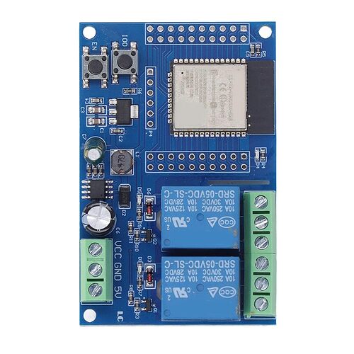

I’m new to the ESP32 experience and have a question. Is there normally a LED on when power has been applied to the board? The only way of knowing if the board is working is to look at the Home Assistant dashboard and see if the button’s I’ve programed are active. I’ve included a picture of the board. If the light is to be “on” then how do I make that happen? Thanks in advance for any help that can be provided.
The board should have an onboard led.
It’s controlled by GPIO23. Maybe turn it on at on_boot: in the ESPHome config.

Presense of LED directly connected to supply power highly depends on manufacturer of board - some have, some not. Can use LED connected to GPIO, but beware - it can activated if/when ESPHome loaded. It is not actually power indicator as You asking.
