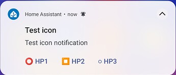

Not sure if that will fit your needs, but you can use unicode to render an emoji inside the action “title”, not all will work though, or look exactly the same, depending on version/vendor…
actions:
  - action: "1"
    title: "\u2B55 HP1"
  - action: "2"
    title: "\u23F9 HP2"
  - action: "3"
    title: "\u2B58 HP3"
Now onto the search for unicorns… codes! :smile:
