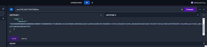

To send something via the web socket, I used the Chrome AddOn Web Socket King Client is used and the Chrome Browser. Postman or similar tools also work in a very similar way.
Start the corresponding tool in my case Web Socket King Client in Chrome.
The top input line (to the left of Connect) should contain the following:
ws://192.168.178.11:5580/ws
(our determined IP address + port)
Press Connect
The message to be sent is entered in the field below:
    "message_id": "1",
    "command": "set_thread_dataset",
    "args": {
        "dataset": "0e080000000000010000000300000f35060004001fffe00208e34cb63b988011600708ed1dd37a69db4a4d0510f34b8d065cf2fd3cb2bbdd3551b94ca4030e686f6d652d617383697374616e740152bf9f0410f2c39e3949ca653fab5ca0b1dd3740b20c0402a0f7f8"
The determined Active dataset TLVs are entered here (the long character string).
Press Send

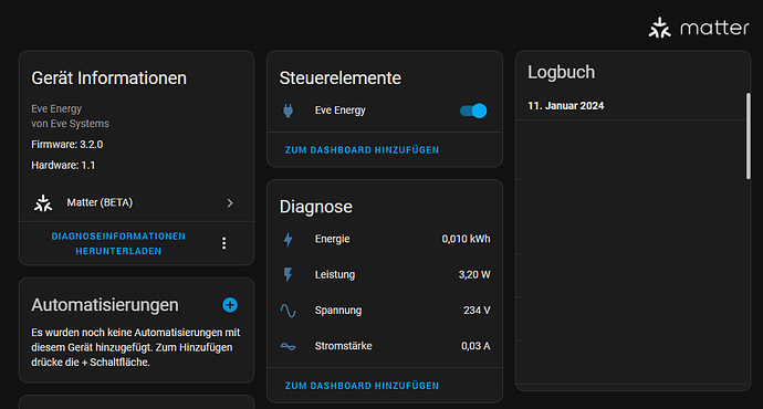

The new Matter / Thread device should appear immediately in the Home Assistant.
Settings → Devices & services → Matter → 1 Device →
