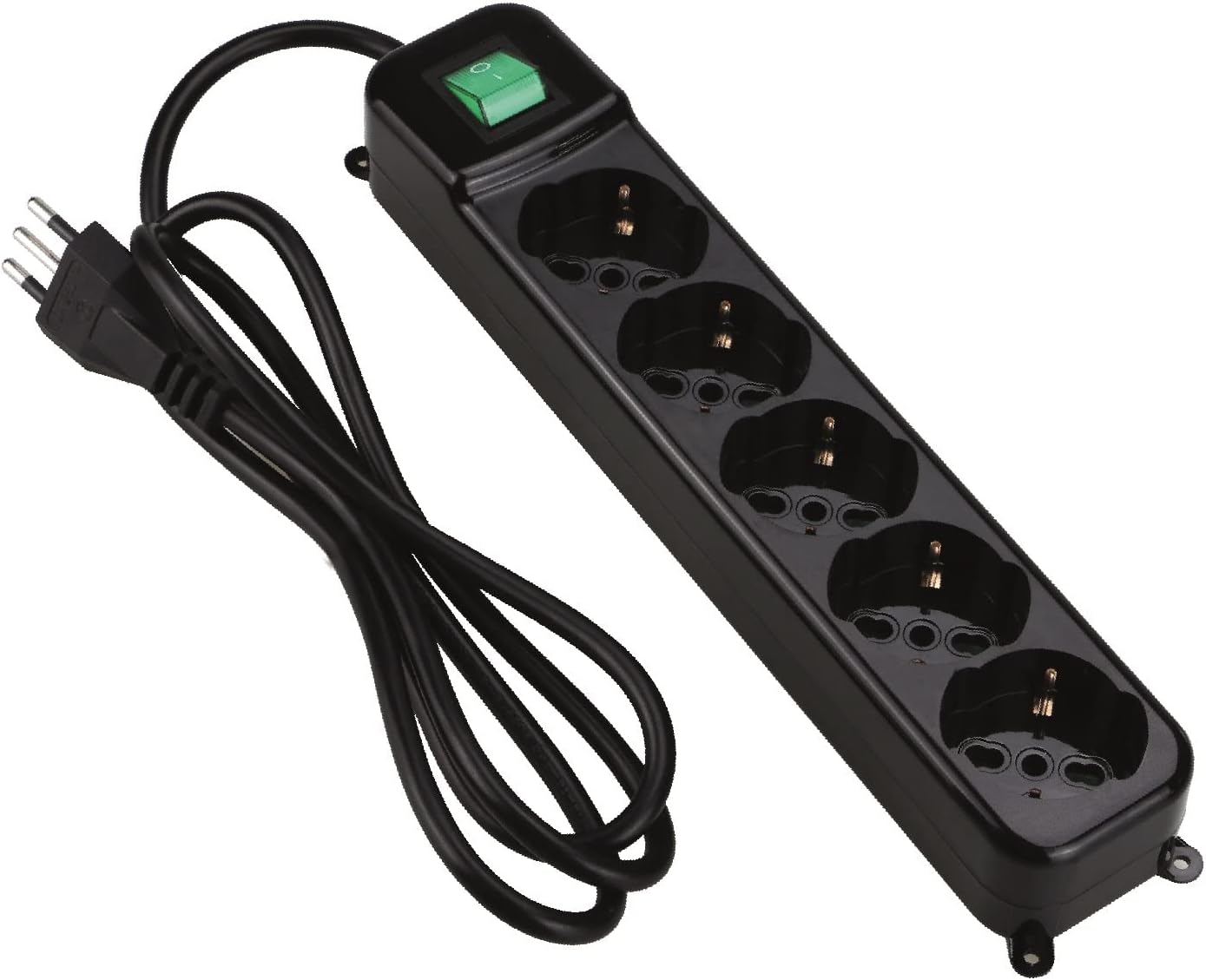

If you don’t have high loads, you could even fit two shelly 2pms inside some power strip.
If you remove the internals of the 5th socket and the switch, likely you fit shellies there. At least I managed to fit Esp dev board, 2-ch relay module and some sensors to similar strip…
Most (especially cheaper) power strips use a set of two continuous metal strips going through all outlets (kept in place by plastic prongs), you generally can’t cable them up individually - and cutting the strips/ soldering cables will affect their stability and spring-like behaviour to graps the plugs. It’s quit unlikely to work out, not that most newer power-strips could be opened ‘neatly’ in the first place (glue, plastic clasps, rivets, etc.).
Some older (high-priced) 19" rack power-strips might actually have individual power sockets (and maybe even enough space in the case for esp32 && relais), but identifying those is the real challenge.
