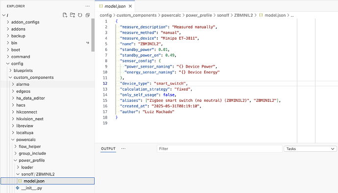

I’m trying to create a custom model for sonoff ZBMINIL2. I have 60+ devices and don’t want to create it manually in home assistant.
I create a model.json (/config/custom_components/powercalc/power_profile/sonoff/ZBMINIL2/model.json).
This is the content:
  "measure_description": "Measured manually",
  "measure_method": "manual",
  "measure_device": "Minipa ET-3811",
  "name": "ZBMINIL2",
  "standby_power": 0.01,
  "standby_power_on": 0.49,
  "sensor_config": {
    "power_sensor_naming": "{} Device Power",
    "energy_sensor_naming": "{} Device Energy"
  "device_type": "smart_switch",
  "calculation_strategy": "fixed",
  "only_self_usage": false,
  "aliases": [
    "Zigbee smart switch (no neutral) (ZBMINIL2)",
    "ZBMINIL2"
  "created_at": "2025-05-31T08:19:10",
  "author": "Luiz Machado"
Should I do something else to get the automatic discovery working ?
Thx
Please see these resources:
https://docs.powercalc.nl/library/discovery/
https://docs.powercalc.nl/library/library/#custom-models
Should provide all the info you need. The directory you have put it in is not right.
After restart or calling service powercalc.update_library discoveries should appear.
Also consider submitting the profile to github so it is part of the Powercalc library.
That being said, 0.01W for standby power cannot be correct as the power needed to supply the chip and zigbee radio will be more than that.

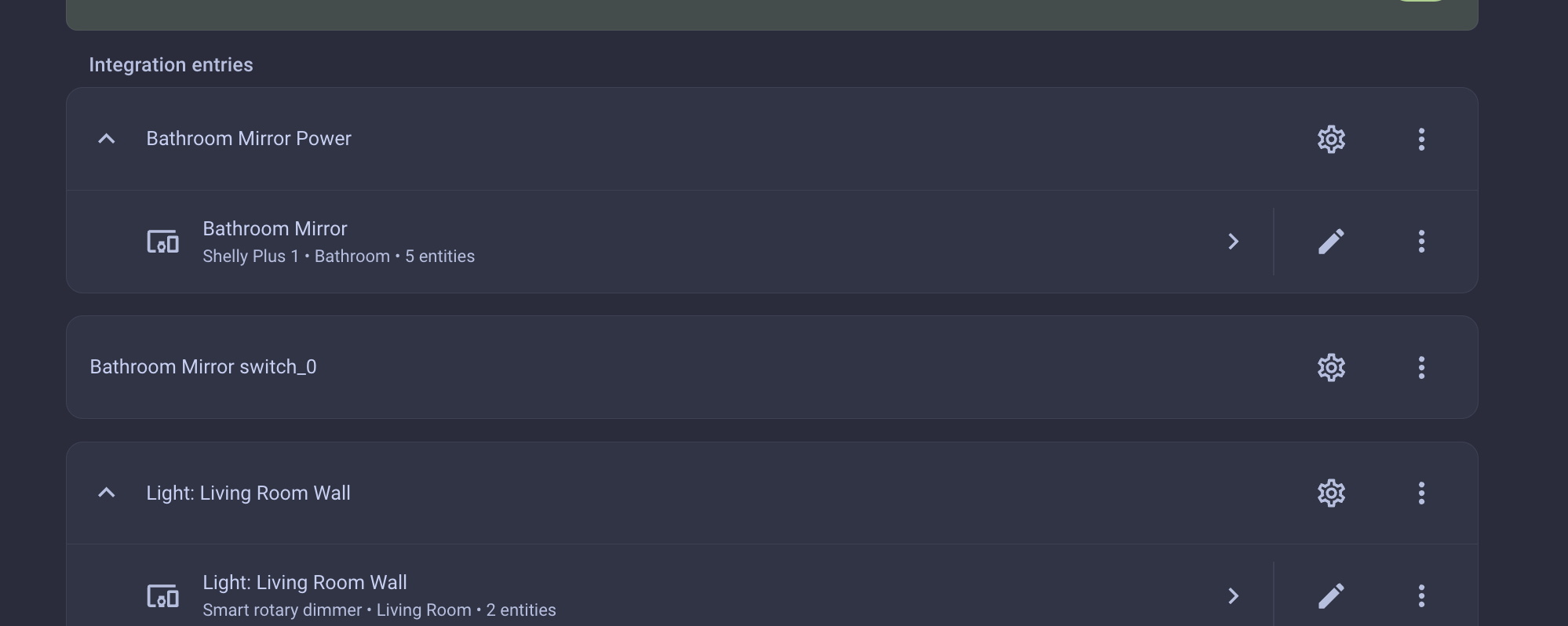

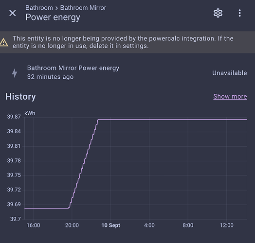

Hi there, all my existing sensors have broken since i updated ha. i get this message
I also cant add new sensor via “add entry”. it just doesnt respond.
i add a new entry via the integration path but the sensor that it create is literally not working.
Many thanks
That’s strange. Anything in the error logs?
This is a known issue for a few weeks now, see It is not possible to add a new entry · Issue #3417 · bramstroker/homeassistant-powercalc · GitHub
It’s very strange as I can’t reproduce it at all on several HA instances, so not sure how to proceed fixing it. Please see my latest comment with a question, would be nice if you can answer that.
Hi Bram,
I just deleted the PowerCalc folder in custom components and also removed all the entities - reinstalled and its started working

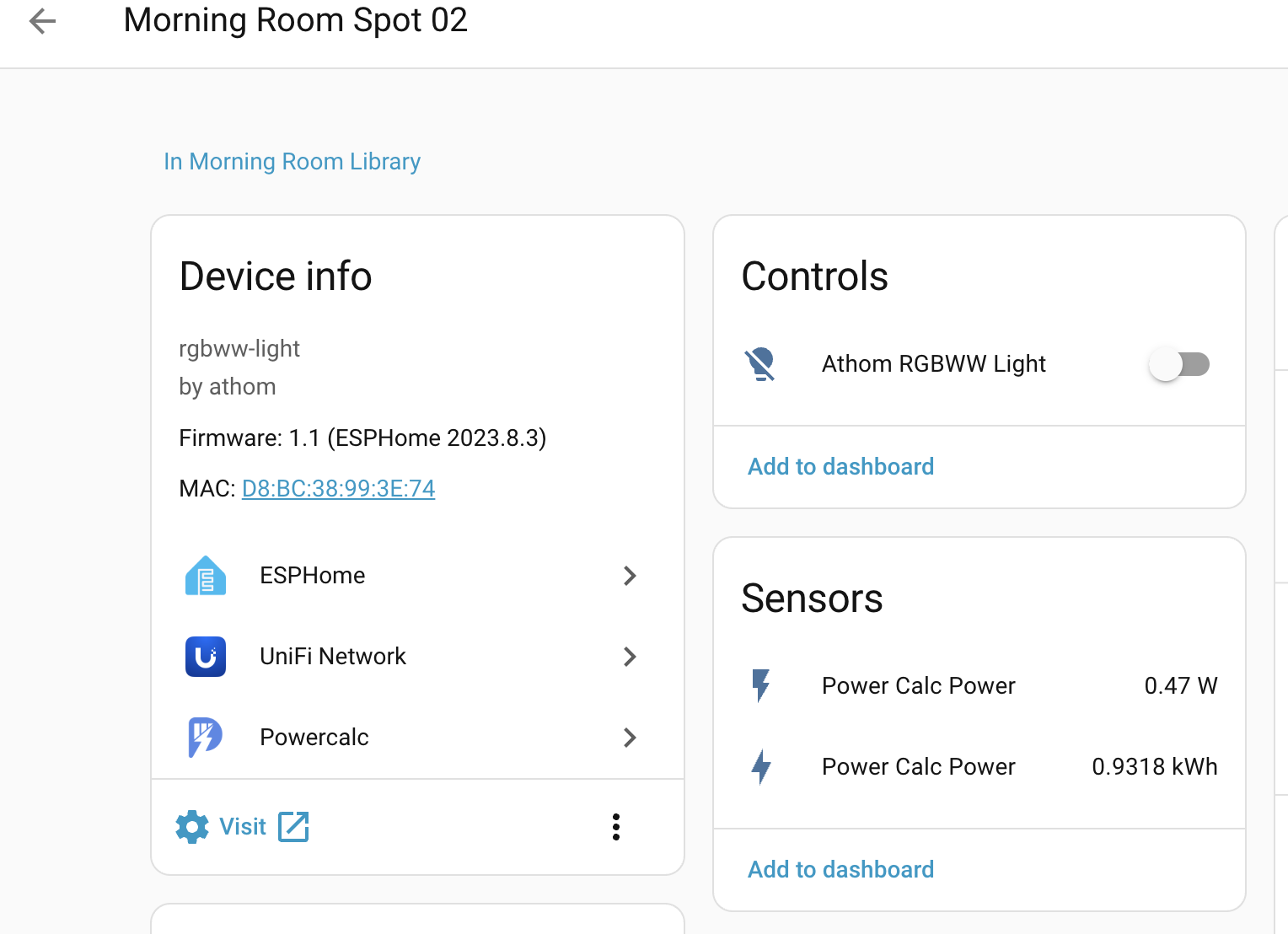

hi - i have a house full of athom eps8266 rgbww bulbs which aren’t detected by powercalc. well, it’s detected 3 of them but not the other 80. any super easy tips as to how i can get the other ones recognised and added?
Are there exactly the same lights as the ones which are detected?
How are they identified in HA when looking in the device page?

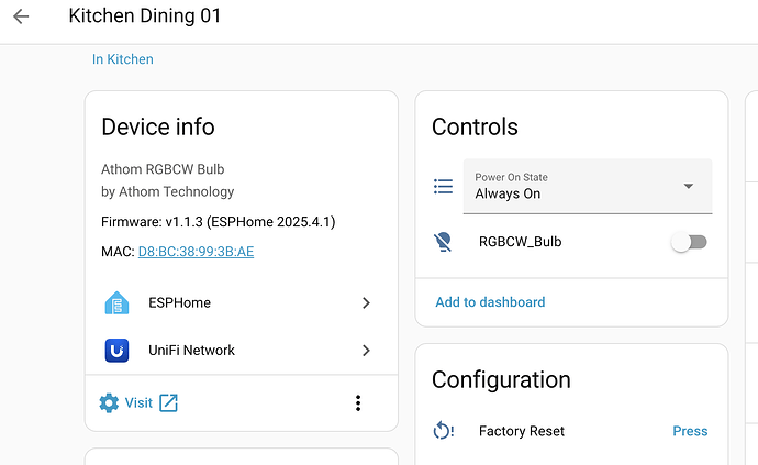

Hi @bramski - yes they are exactly the same as the ones already detected. Here’s a screenshot of the device page:
actually, @bramski doing this discipline has made me relook at the athom bulbs that HAVE shown up and i can see that they are on earlier versions of the firmware and earlier versions of the esphome framework:
Any updates with that?
Could you please make an issue on github?
No, not yet.
done, many thanks for looking at it when you get there. let me know if you need any more info
