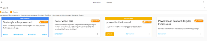

That is a picture from the supervisor add-on store. Powercalc is not an add-on !
Use HACS :

You should go to the ā€œIntegrationsā€ tab, seems you are on the frontend tab. Then you should find the integration when searching for power.
You don’t have to add any custom repository. powercalc has been added to the default HACS repository which is build in.
I found it thanks!
