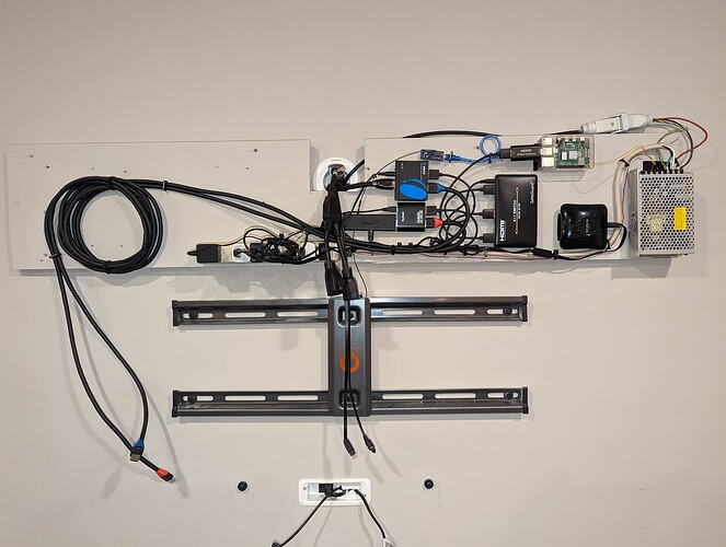

So I ended up using a broadlink along with an RF HDMI switcher all mounted behind my TV. Pictures attached of complete setup and then TV hiding it all.
