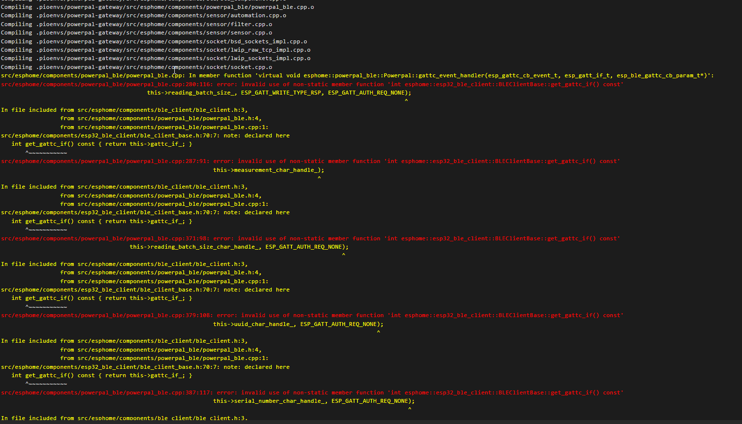

what is the current way of getting the esp32 to even work. i keep getting compiling errors.

Has anyone got a working config file for an ESP32 they can share? I keep getting compile errors using the config file in the github repo⌠latest v of HA and ESPHome

I used the one in this thread a few posts up from Sabellwind
