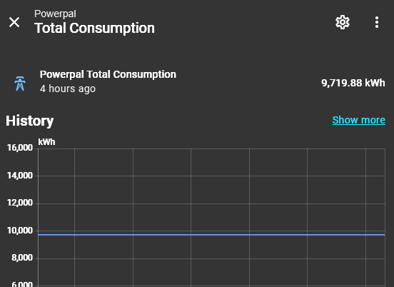

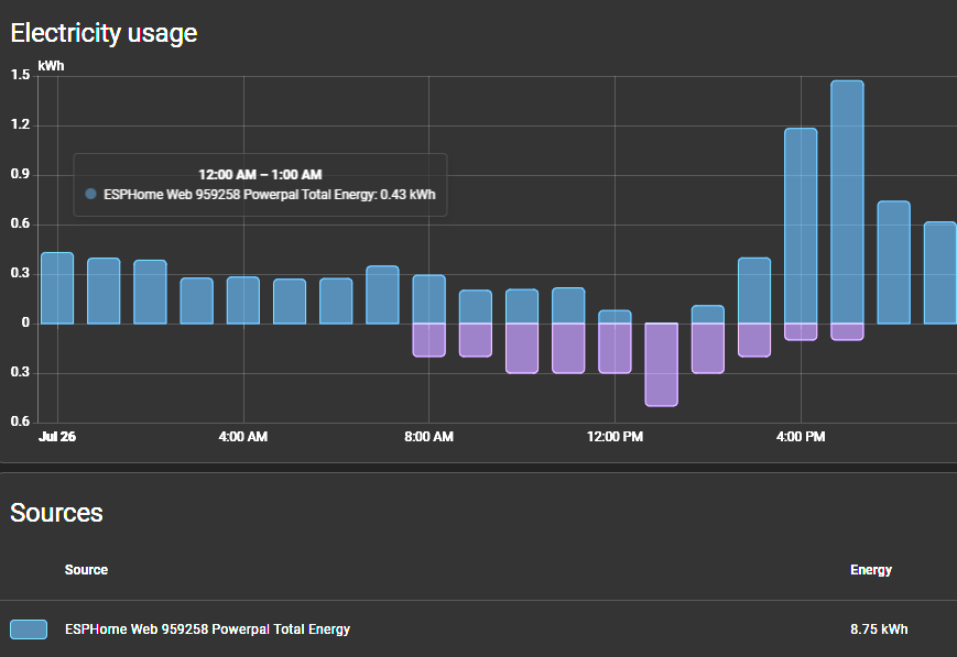

Sorry what I’m trying to say is that the Total Energy is reporting incorrectly. It’s only marginally higher than the Daily, whereas it should be many orders of magnitude greater. Total for me should be almost 10kWh but its reporting much less than that, as seen above.
The Total Energy will be EXACTLY the same as the Daily Energy on day 1. After midnight, once the Daily total resets to zero, you will see the Total Energy start to climb further as it will be the sum of Daily day 1 plus daily day 2 so far.
Total Energy is not an overall reading from the lifetime of the Powerpal. I have not tried to do that and am unsure if it actually is reported.
It reporting total lifetime usage was how it was previously working for me?
Edit: Ah ok so my HAOS energy ‘source’ for grid consumption was wrong. It was configured to use this “Powerpal Total Consumption” entity from the Powerpal Integration which is not being updated? Once I updated to the entity “ESPHome Web 959258 Powerpal Total Energy” my data updates correctly:
Given the entities as part of the Powerpal Integration do not seem to be updating, do I in fact need this integration at all?
I’ve put this in, looking good so far, will report any issues.
