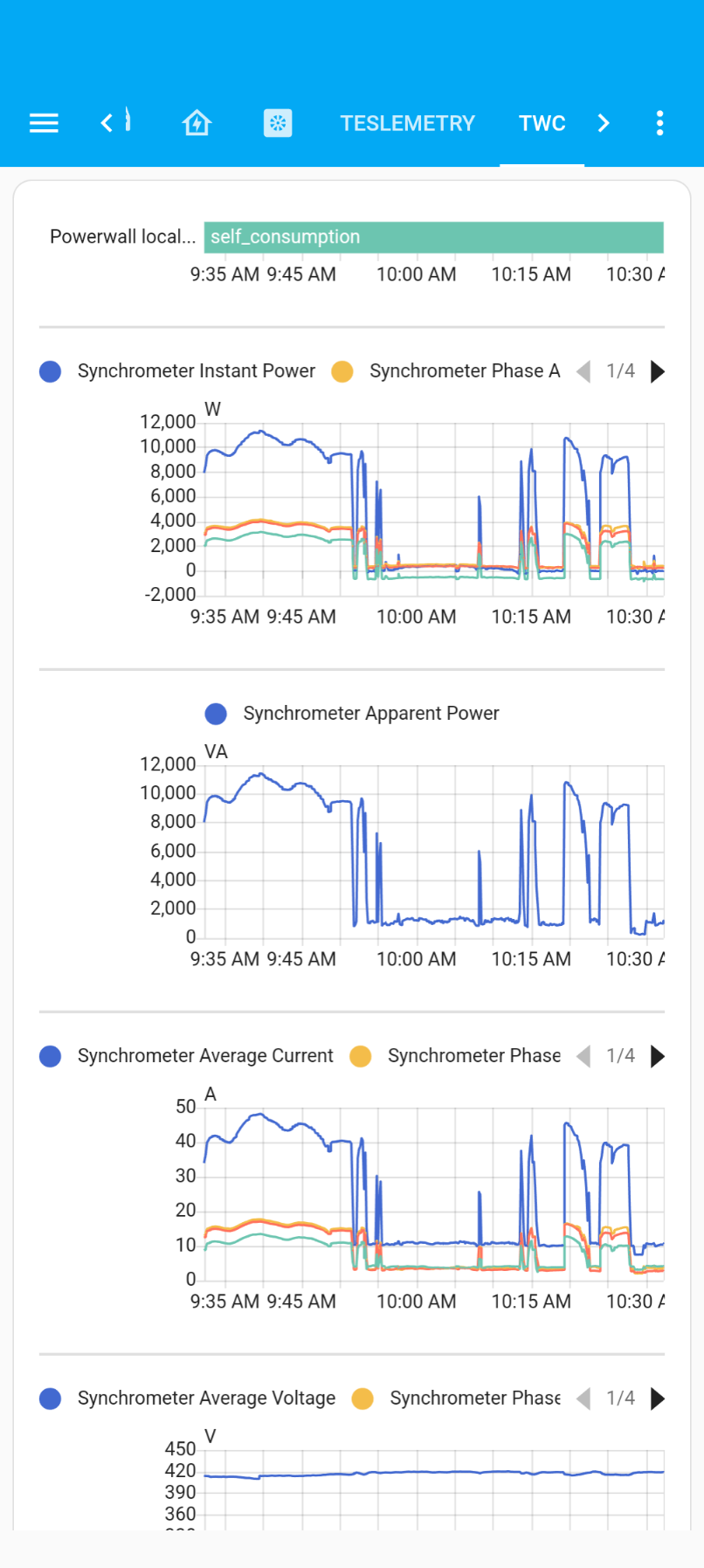

Can the Powerwall integration be enhanced to support breaking down voltages, frequency, temps, and capacity similar to what pypowerwall can do? See attached screenshot for what is possible using that tool. Would be nice to extract from Home Assistant vs having yet another process/server to run pypowerwall.
Thx!
