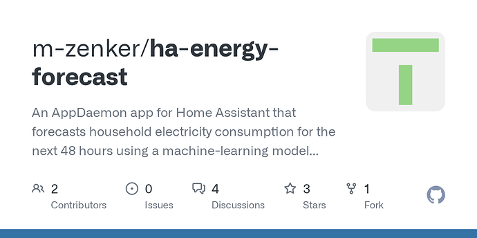

If anyone is still interested, take a look at this:
This is a project I’m actively working on. My use case is for load shifting according to solar production as well. The predictions are now running for some weeks on my system and already quite good.
Let me know if it works or if you need support with the setup.
