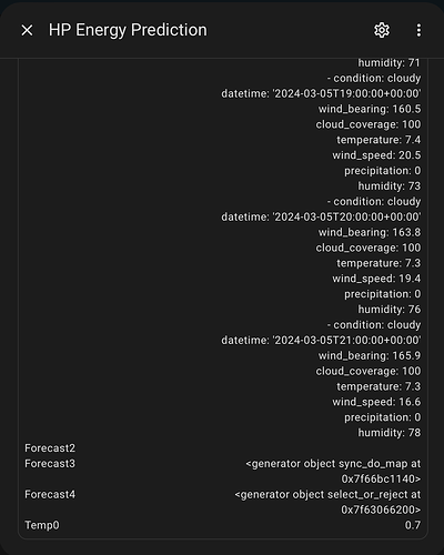

Q2. Getting the forecast data - for step 1 above, it looks like the example here ought to be spot on. (I would then in edit the sensor attributes section at the bottom to perform my calculations and produce an output in the correct format, but let’s get the basics working first.) A few tweaks seem necessary (e.g. entity_id: weather.forecast_home not weather.home), as per this thread. But I can’t seem to get this to work at all - it just results in “Unavailable”.
To be specific, I am pasting the following into a new template sensor:
template:
- trigger:
- platform: time_pattern
hours: /1
action:
- service: weather.get_forecasts
type: hourly
response_variable: hourly_forecast_data
sensor:
- name: Weather Forecast Hourly
unique_id: weather_forecast_hourly
state: "{{ now().isoformat() }}"
attributes:
forecast: "{{ hourly_forecast_data['weather.forecast_home'].forecast }}"
None of the available options in the ‘Unit of measurement’, ‘Device class’ or ‘State class’ menus seem appropriate, so I have left these blank - if these should be set to something specific, please advise.
I can see that the service call seems to work - pasting the following into Developer Tools > Services gets a sensible output:
type: hourly
But it doesn’t seem to be doing anything when put into the template sensor.
