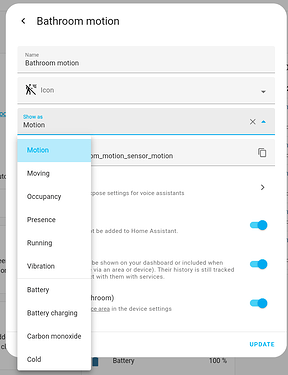

Does your presence detector have a “show as” option?
If so, you could experiment with those - some options (like motion) change the icon automatically.
It does have that option, and I can change it to “show as” motion.
