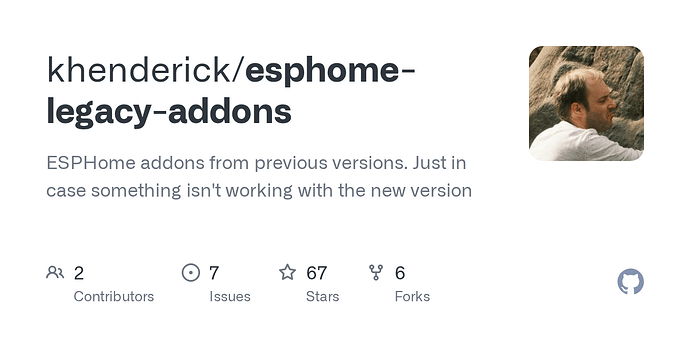

I run two versions of ESPHome for similar reasons - the current one and an older one using a version from this repository:
Turn off update notifications for the ones you want to leave alone. All devices will appear in both ESPHome Builder versions still.
