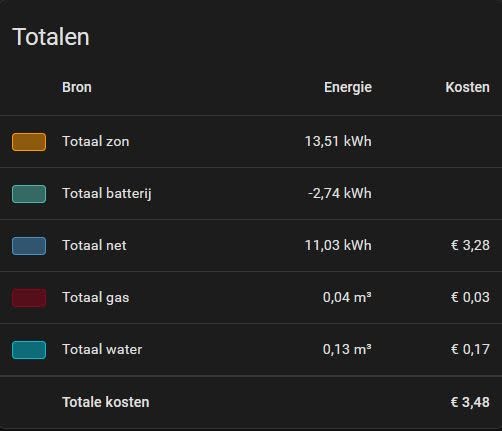

On the beautiful page Energy, all sensors are well set and are also visible. The problem I am facing loop is that the currency is not shown at the solar yield and the battery yield. The sensors with information about the prices with EnergyZero and Norpool are created and also work on other pages. However, I do not get this one in the Energy page. According to AI, this is not possible either… Is it?
Any help?
It is possible for solar, but not for the battery — and that’s just how the Energy dashboard is built. Monetary values are only shown for grid consumption and return to grid; solar yield and battery flow are displayed in kWh only. For solar there is an optional compensation setting: open the Energy configuration, edit your solar setup, and enter a price (static or a price entity such as your Nord Pool or EnergyZero sensor) so self-consumed solar gets a value. For the battery there is no cost column at all — the common workaround is a template sensor that multiplies charged/discharged kWh by your tariff and shows it on a separate dashboard card.
