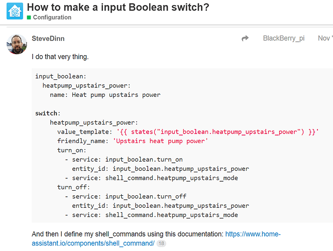

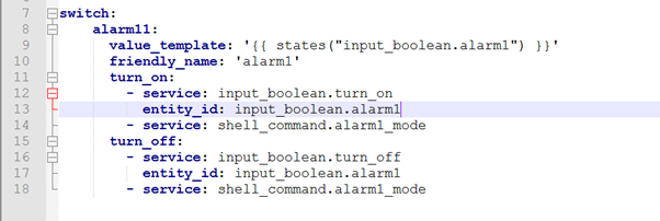

And created an Input Boolean:
Which I believe that I have turned in to a “virtuel switch”:

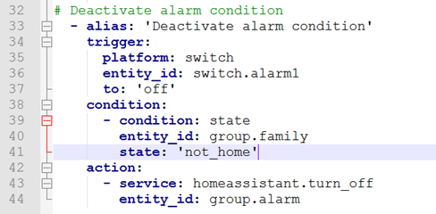

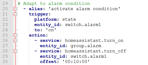

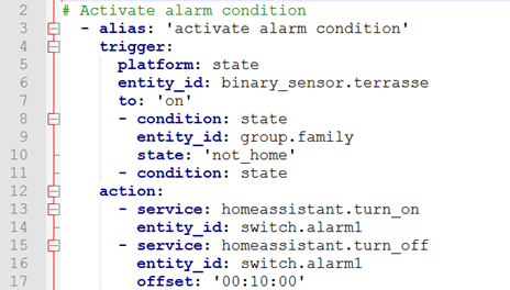

And finally made these automations:
But, it seems like it isn’t working. Any ideas?
I know that I am probably over complicating it, but I am trying to keep the different things separate, to make sure that I can follow it.
For people to more easily help you with the code it would best to actually paste the code into the forum as text as opposed to using a picture of an editor window. And make sure you properly format the code by using the instructions from the top of the page.
