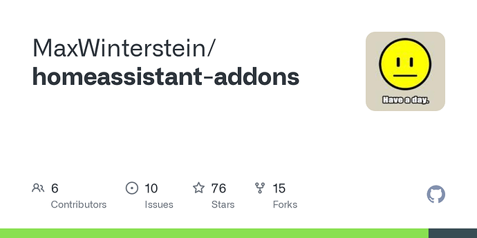

New add-on by @MaxW
Is any better than GitHub - ncarr/addon-repository: Nicholas' Home Assistant addon repository?
This addon works great!
Can you please mark it as solution so new users do not need to read the whole tread
