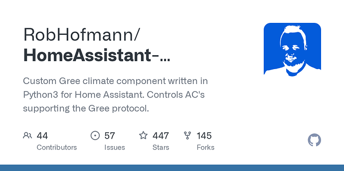

The above HACs integration solves all the previous issues (with “Default” swing mode being the equivalent to a pause); except for the delay when showing updated states in Home Assistant.
It achieves full feature parity and then adds more.
Deleting the old Home Assistant entities (as they’re tied to the original integration), then re-adding the integration (as this one overwrites the core), works. I am still able to use the app as well.
