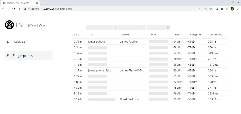

I’ve enabled the Private BLE Device integration and in the first step it’s asking for the Identity Resolving Key (IRK) which I don’t have but the instructions to get it are only for Mac OS and ESPresence which I also don’t have.
Someone knows a way to get the IRK on Windows or Linux?
Thanks.
If you set up espresense it will store the irk in an mqtt topic. Thats what I did. Seemed a helluva lot easier

I followed this guide to get the IRK
I found a way for iPhone and Apple Watch to get the key.
I am making a topic with all the instructions and will link it here!
I wrote a guide on how to get it with a ESP32 or M5STACK Atom.
GUIDE - Getting the IRK for iPhone and Apple Watch (Maybe also other devices?) - Community Guides - Home Assistant Community (home-assistant.io)
