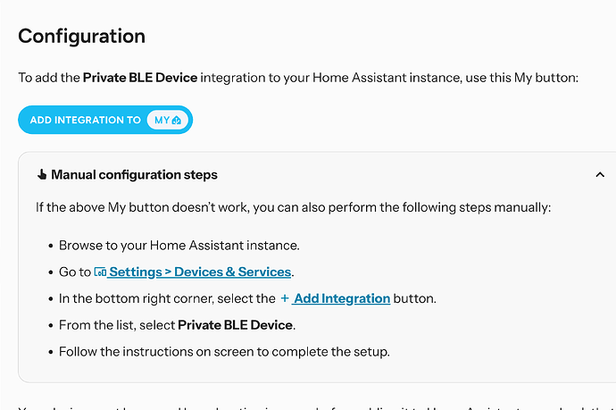

There isn’t much info on how to set up the Private BLE integration. I went to the official HA Private BLE page Private BLE Device - Home Assistant and this is what they say
When you follow those instructions you will see something like this
But you probably have no idea what an IRK is or how to get it. Oddly enough if you X out of that menu since you don’t have your IRK when you go back to devices and services you won’t see the integration. You have to click on “add integration” again.
