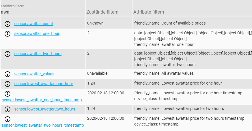

Here is what I crafted as additional sensor (keeping the other two untouched for the time being):
#aWattar Strompreise
  - platform: rest
    resource: https://api.awattar.de/v1/marketdata
    json_attributes:
      - data
    scan_interval: 60
    value_template: >
      {%- set awattar_all_list = value_json.data | list %}
      {{ awattar_all_list }}
    sensors:
      awattar_count:
        friendly_name: "Count of available prices"
        value_template: >-
          {% set count = state_attr('sensor.awattar_all_values', 'data') | list | length %}
          {{ count }}
      awattar_values:
        friendly_name: "All aWattar values"
        value_template: >-
          {%- set awattar_all_list = value_json.data | map(attribute='marketprice') | list %}
          {%- set values_all = namespace(all=[]) %}
          {% for i in range(awattar_all_list | length) %}
           {%- set v = (awattar_all_list[i] | float * 100/1000 * 1.19) | round(2) %}
            {%- set values_all.all = values_all.all + [ v ] %}
          {%- endfor %}
          {{ values_all.all }}
Totally unexpected at all I don’t get a sensor with the name “awattar_all_values” at all in my entities list.
As this sensor is not there the two template sensors give the reading “unavailable”.
:woozy_face: :woozy_face: :woozy_face:
As I said before, my programming skills are really not great and from a long time ago.
Maybe digging deeper here can help other people later on as I expect this power provider to become more popular in the future.
Hah, fixed it :slight_smile:

  - platform: rest
    json_attributes:
      - data
    scan_interval: 60
    value_template: "{{ (value_json.data[0]) }}"
    sensors:
      awattar_count:
        value_template: >-
          {% set count = state_attr('sensor.awattar', 'data') | list | length %}
          {{ count }}
      awattar_values:
        value_template: >-
          {%- set awattar_all_list = state_attr('sensor.awattar', 'data') | map(attribute='marketprice') | list %}
          {%- endfor %}
      awattar_one_hour_min:
        friendly_name: "aWattar one hour minimum value index in available dataset"
        value_template: >-
          {%- set awattar_list = state_attr('sensor.awattar', 'data') | map(attribute='marketprice') | list %}
          {%- set values = namespace(min=[]) %}
          {% for i in range(awattar_list | length) %}
           {%- set v = (awattar_list[i] | float * 100/1000 * 1.19) | round(2) %}
            {%- set values.min = values.min + [ v ] %}
          {%- endfor %}
          {{ values.min.index(values.min | min) }}
      awattar_one_hour_min_value:
        friendly_name: "aWattar one hour minimum value in available dataset"
        value_template: >-
          {%- endfor %}
          {{ values.min | min }}
      awattar_one_hour_timestamp:
        friendly_name: "aWattar one hour minimum value timestamp in available dataset"
        device_class: timestamp
        value_template: >-
          {% set index = states('sensor.awattar_one_hour_min') | int %}
          {% set table = state_attr('sensor.awattar', 'data') %}
          {{ ( table[index].start_timestamp | int / 1000 ) | timestamp_local}}
      awattar_two_hour_min:
        friendly_name: "aWattar two hour minimum start index"
        value_template: >-
            {% if i + 1 < awattar_list | length %}
              {%- set v = (awattar_list[i] | float * 100/1000 * 1.19 ) | round(2) %}
              {%- set next = (awattar_list[i+1] | float * 100/1000 * 1.19 ) | round(2) %}
              {%- set values.min = values.min + [ v + next ] %}
          {%- endfor %}
      awattar_two_hour_timestamp:
        friendly_name: "aWattar two hour minimum value start timestamp in available dataset"
        value_template: >-
          {% set index = states('sensor.awattar_two_hour_min') | int %}
      awattar_four_hour_min:
        friendly_name: "aWattar four hour minimum start index"
        value_template: >-
            {% if i + 3 < awattar_list | length %}
              {%- set v1 = (awattar_list[i] | float * 100/1000 * 1.19 ) | round(2) %}
              {%- set v2 = (awattar_list[i+1] | float * 100/1000 * 1.19 ) | round(2) %}
              {%- set v3 = (awattar_list[i+2] | float * 100/1000 * 1.19 ) | round(2) %}
              {%- set v4 = (awattar_list[i+3] | float * 100/1000 * 1.19 ) | round(2) %}
              {%- set values.min = values.min + [ v1 + v2 + v3 + v4 ] %}
          {%- endfor %}
      awattar_four_hour_timestamp:
        friendly_name: "aWattar four hour minimum value start timestamp in available dataset"
        value_template: >-
          {% set index = states('sensor.awattar_four_hour_min') | int %}
