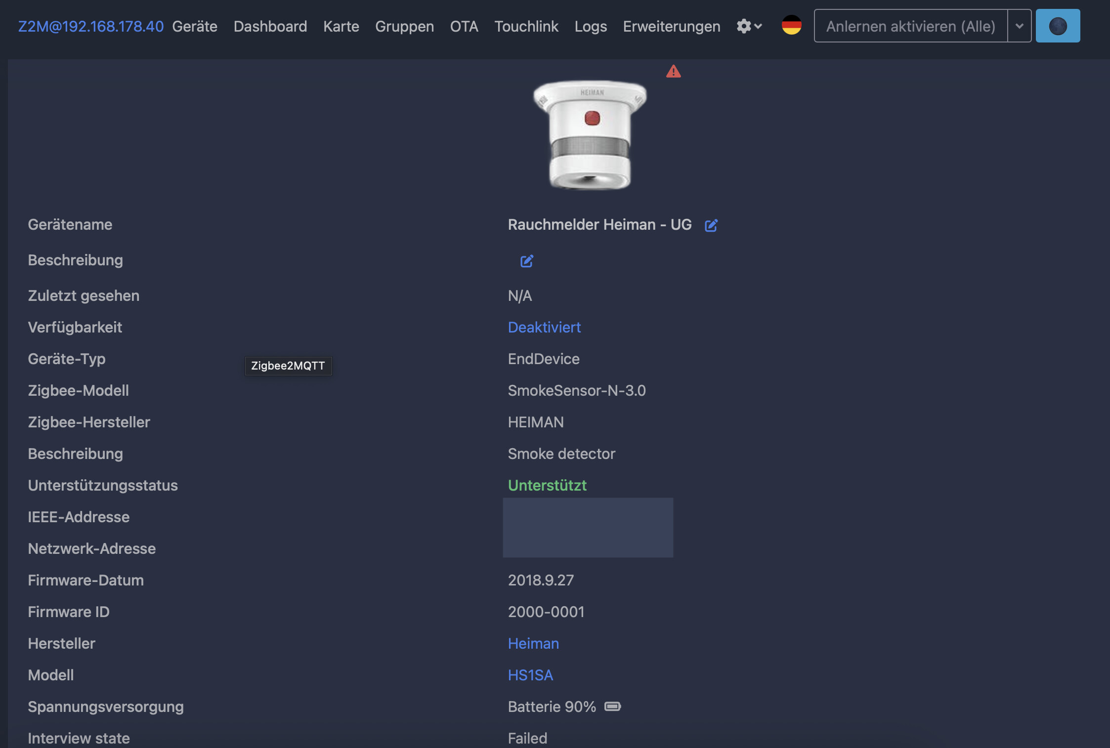

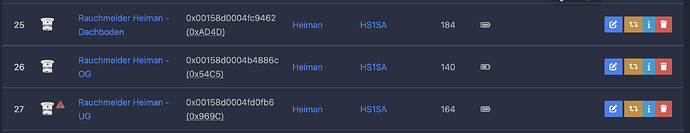

1. Pairing
For each smoke detector, it took at least 3 attempts until they were paired without a warning (red exclamation mark).

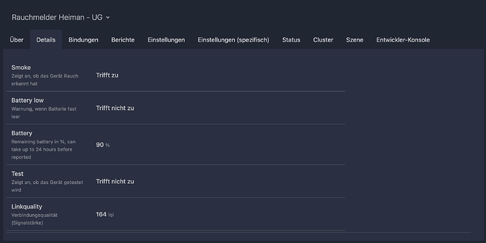

2. Smoke detection flag
Test alarms were successfully detected, and the smoke detection flag was set.
However, it does not reset automatically. I can reset it manually, but it always switches back to on and triggers a critical alarm after every HA restart.
3. Integration failure
The smoke detector I tested now shows that it wasn’t properly integrated. I’ll try to re-pair it again this weekend.
Here are the logs when trying “Reconfigure”:
Error 2025-08-24 18:12:58 z2m: Failed to configure 'Rauchmelder Heiman - UG', attempt 2 (Error: Bind 0x00158d0004fd0fb6/1 genPowerCfg from '0x8c65a3fffe54c55d/1' failed (Delivery failed for '38556'.) at EmberOneWaitress.deliveryFailedFor (/app/node_modules/.pnpm/[email protected]/node_modules/zigbee-herdsman/src/adapter/ember/adapter/oneWaitress.ts:100:31) at EmberAdapter.onMessageSent (/app/node_modules/.pnpm/[email protected]/node_modules/zigbee-herdsman/src/adapter/ember/adapter/emberAdapter.ts:458:42) at Ezsp.emit (node:events:518:28) at Ezsp.ezspMessageSentHandler (/app/node_modules/.pnpm/[email protected]/node_modules/zigbee-herdsman/src/adapter/ember/ezsp/ezsp.ts:5076:14) at Ezsp.callbackDispatch (/app/node_modules/.pnpm/[email protected]/node_modules/zigbee-herdsman/src/adapter/ember/ezsp/ezsp.ts:734:26) at Ezsp.onAshFrame (/app/node_modules/.pnpm/[email protected]/node_modules/zigbee-herdsman/src/adapter/ember/ezsp/ezsp.ts:387:22) at UartAsh.emit (node:events:518:28) at Immediate.<anonymous> (/app/node_modules/.pnpm/[email protected]/node_modules/zigbee-herdsman/src/adapter/ember/uart/ash.ts:1194:45) at processImmediate (node:internal/timers:485:21))
Interview error:
Error 2025-08-24 18:14:56 z2m: Request 'zigbee2mqtt/bridge/request/device/interview' failed with error: 'interview of 'Rauchmelder Heiman - UG' (0x00158d0004fd0fb6) failed: Error: Interview failed because can not get active endpoints ('0x00158d0004fd0fb6')'
Do you have any idea what I could try?
