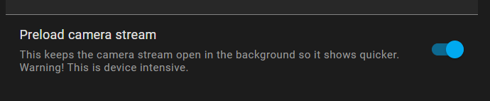

Check “preload stream” option. Camera - Home Assistant

PS: picture-entity-card( chose “Live” ) … I don’t have “Preload Stream” enabled anywhere, as i rather want as low usage as possible

What’s the performance impact of preloading the camera streams?
This should fix the cameras being spotty when loading the dashboard, but how could it affect performance? I have a Pi 5, and it’s not clear to me how bad this could be.
Does it just use lots of network perfomance or CPU? The CPU looks to still be around 3%.
