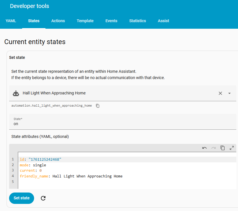

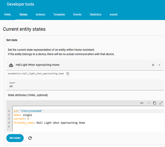

as a test i went into developer tools > states > set state on that automation and the light came on, so i assume the issue is with the location based trigger?

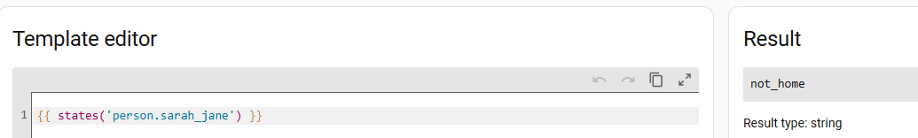

What do you get when you type this into developer tools → template:
{{ states('person.simon') }}

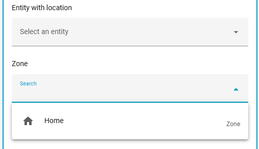

i selected the zone from the list so i would assume that is correct

if i click set state on this the light turns on
You are running the automation, so yes…

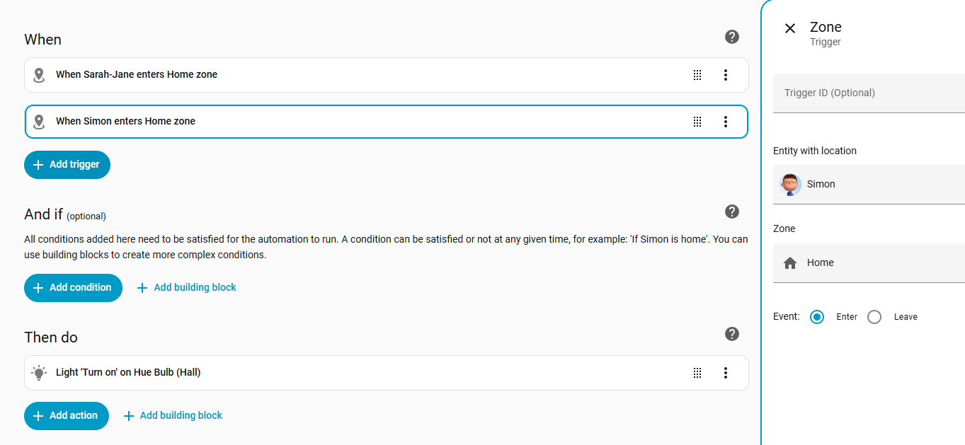

this is how it visually looks in the UI
and the yaml

Try a different trigger.
Or as suggested before use the count of the state of zone home just for testing.
But I would rather use the state trigger than the zone trigger.

the person state is defintely working, as my partner is now out the house and their state is showing as not_home
so at least i know that part is working correctly.
it changed to not_home shortly after leaving the house (enough time get out the zone defined area)
