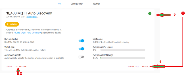

Green ?
Config rtl_433 MQTT Auto Discovery
INFO rtl_433 MQTT Auto Discovery
TEST
CONFIGURER
START LISTENNING
rtl_433 is green. Do not use autodiscovery, added sensors manually.
