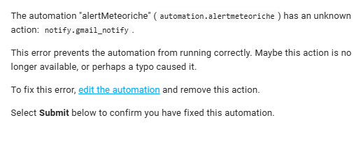

but when i reload all I can’t see smtp
I also have problems with an automation

when I execute it I have
Also yams is broken when I come back because notify.gmail_notify disappears

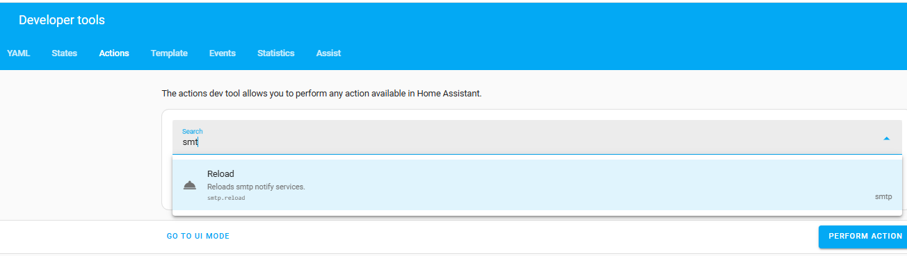

If you never had smtp before, a reload won’t load it. A full restart of HA is required.

Already restarted.

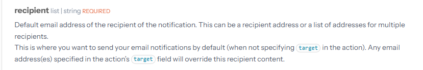

You’re missing required recipient
thanks, but I removed it removing other infos because I thought it was optional.
