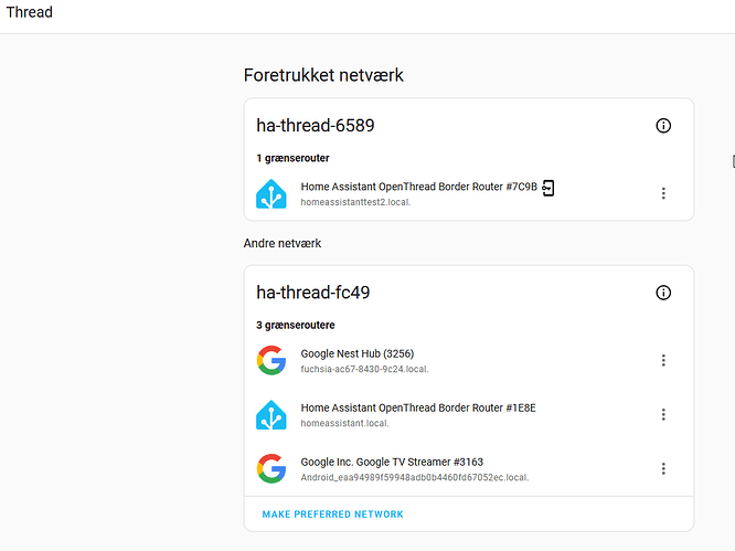

I’ve set up a Home Assistant for a video, and connected a new thread adapter to it.
In HA I’ve set it up to use a new thread network as the preferred:network:

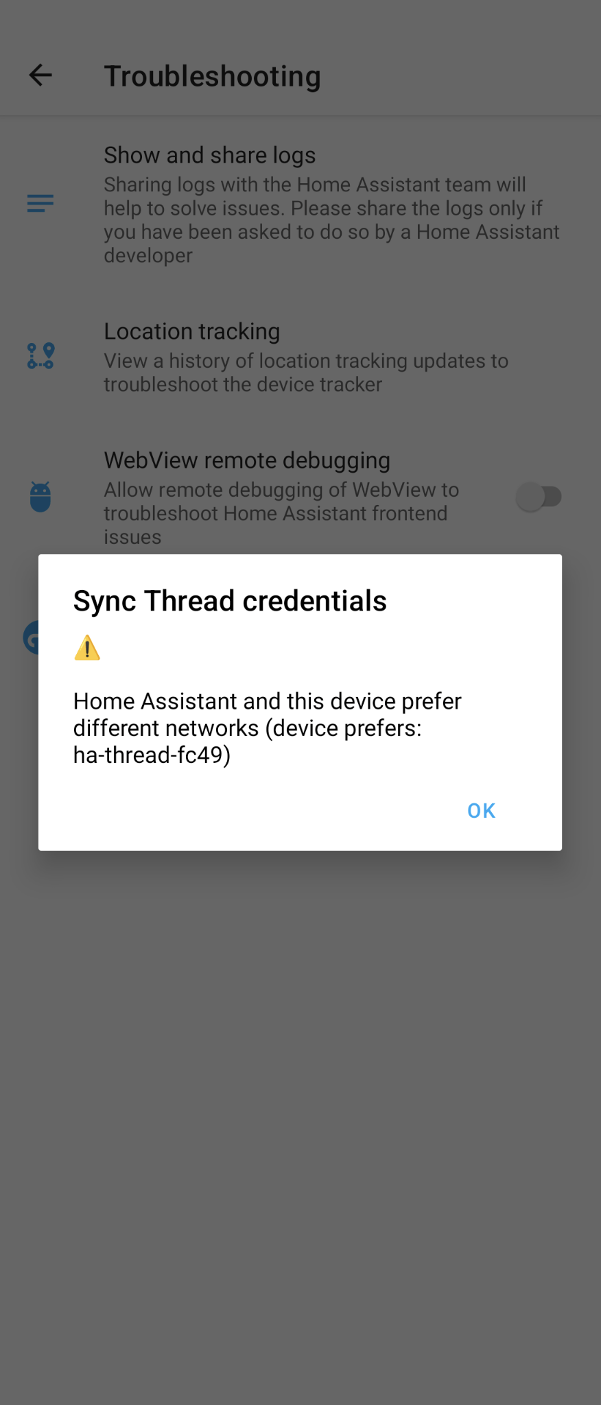

But when I go to the cellphone which is logged into the same HA, and under troubleshooting asks it to synchronize Matter credentials (so I can add a device) I get this message:
I don’t understand why it does that?

Hi @WallyR
Thankyou for the suggestion. I’ve gone and picked up a spare phone that has been factory reset, but it still shows the same problem on that phone.
Then your Google TBRs are the primary ones and you probably need to change the settings in the app for these.
Darned, so I cant have two parallel thread networks on the same VLAN? But if I move it to a seperate VLAN with seperate ssid it should be ok?

I have my own home assistant running, but I also do videos for YT, and in that context I wanted to set up a test home assistant just for this.
So I created a new VM with HA on it, and connected a new zigbee / thread dual radio adapter (SMLIGHT-MR1) for this.
So I have a seperate VM for this. But apparently that is not good enough. After moving the new HA to a DMZ along with the thread adapter to it, it now doesn’t see the old thread network that is running all my internal stuff, and now it works, I can sync credentials to the mobile (which is also on the DMZ). Thankgod Unifi can handle 8 SSID’s, otherwise I would be in trouble :slight_smile:
