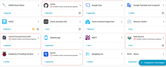

Home assistant seems to run but a lot of configuaration don’t.
see below printscreen.

So I’m using a raspberry pi 5 connected via wifi.
I fear it has indeed something to do with the SD card not linking power shortage.
SD card isn’t recognized by PC when I’m inserting in PC.
I’m currently scanning SD card with Tenorshare

Seems that I managed to restore the SD card, not sure how I did it. :upside_down_face:
