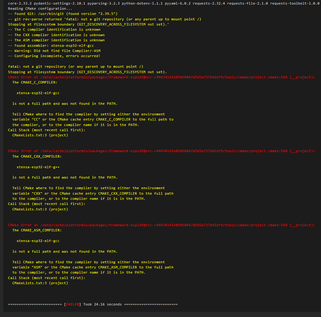

Hi. For about two weeks now I can’t even compile a basic firmware for esp32. I create a new device, fill in the required fields, click install, everything goes well at first, but each time it ends with such messages.
Firmware for esp8266 compiles and loads normally. :roll_eyes:

The server itself has been rebooted more than once. Delete? Won’t I lose all my projects and devices because of this? I didn’t even think about doing that.

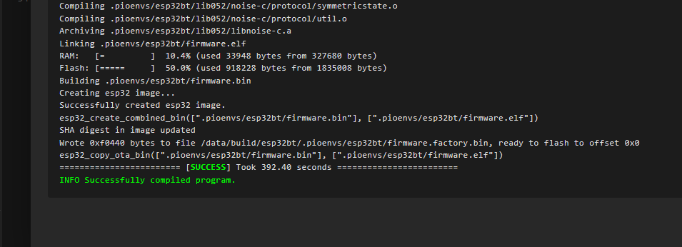

upd: Ok, it looks like a simple reinstallation of esphome helped. I thought it was some kind of bug and just waited for the next updates.
No, if you remove the add-on, your yaml files are not deleted. However it is always good to have a backup of them.
