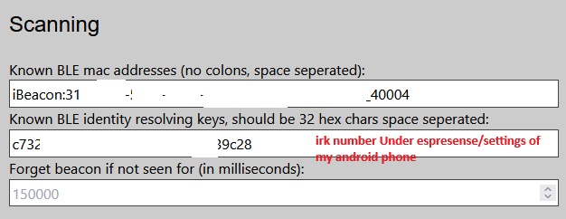

I know this is an old thread but are you putting the ID’s in espresense to track? I use Android and I know there are some difference but in the companion app it creates a sudo BT address under sensors and that’s the ID I use. Not really seeing any point in masking it because it’s not real (per say) BT MAC and an option the only broadcast when you’re on your home network but iOS may be different. After turning on the BLE tracker sensor everything works for me.There is an iBeacon integration also, not sure what it’s for though. I removed “Distance” from the screenshot below. I don’t know how that got there probably when I was trying to set it up
HA Settings > companion app > sensors (Android only)

EDIT: realized my friend had an iPhone so only one that showed up in espresense. It needs to be added to 'Counting" in espresense at a minimum After adding it and rebooting home assistant it showed up right away. No sensor, just use the apple:xxxxx-x value that shows up in espresense . IRK 32 key goes into " resolving keys" in espresense, not counting. According to the documentation you can hit enroll in espresense web UI then accept the connection on your phone or iPad but 32 character key specified is probably the better method. I probably did the manual way using Apple:xxxxx-x
Add the output (which should be 32 characters) to the ‘Known BLE identity resolving keys’ section of the ESPresence configuration.

and THE MOST IMPORTANT THING :
in each espresence node, you have to put the id of BLE Transmitter of your Android phone, in HA Companion App, under sensor :
my phone is enroll with this infos :
Sans titre2
hope it will help you guys :slight_smile:
