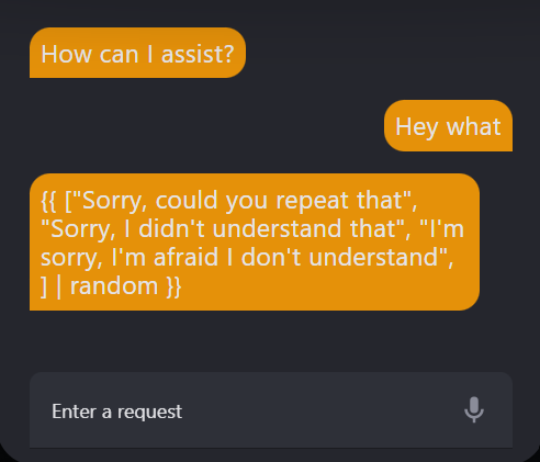

Here’s the response I’m getting:
Any other thoughts?
Have you tried adding the apostrophe at the start and end as I described abobe?
Adding single or double quotes to a template already demarcated by a block scalar indicator, > or |, will not fix OP’s problem and will just cause other issues.
