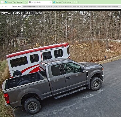

By selecting “run actions” on my test automation, I’ve verified that the snapshot is actually being created:
and I can view it locally:
I am receiving both the email and MMS message but without the image! The email just show a broken image icon, and the MMS message just has the subject/title and the message text.
