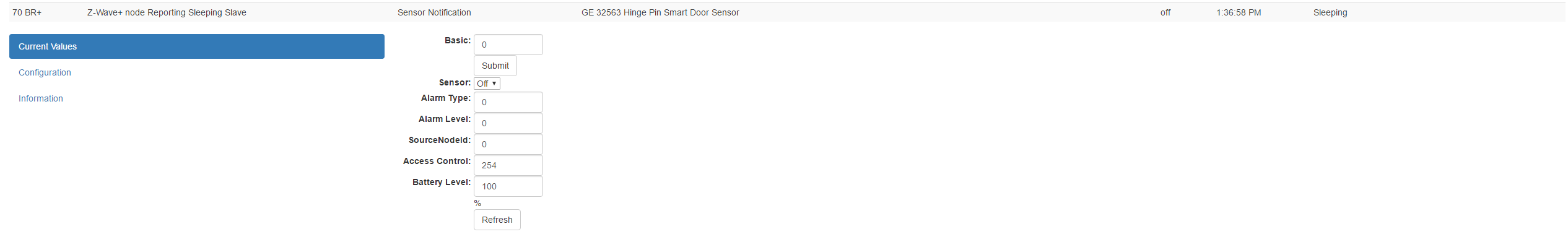

When that was all started and going I could see why not everything had not showed up:
This is the primary reason I just go through the process of pairing directly with the Z-Stick. This has happened many times. In fact, even after I shut down OZWCP and restart Home Assistant, I still have to restart it one more time to get all the entities to show up.
At any rate, I let OZWCP go through its process to poll the device and get the configuration information.

However, activating the sensor just did not change the state of the binary sensor at all. I went back into OZWCP to see if I could get a grasp on what was going on. One of the things I noticed is that there is no way to keep the device awake (at least that I have found) more than a very brief second. As such, I was unable to change its reporting status from notification to even Basic Set.
