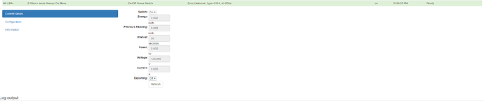

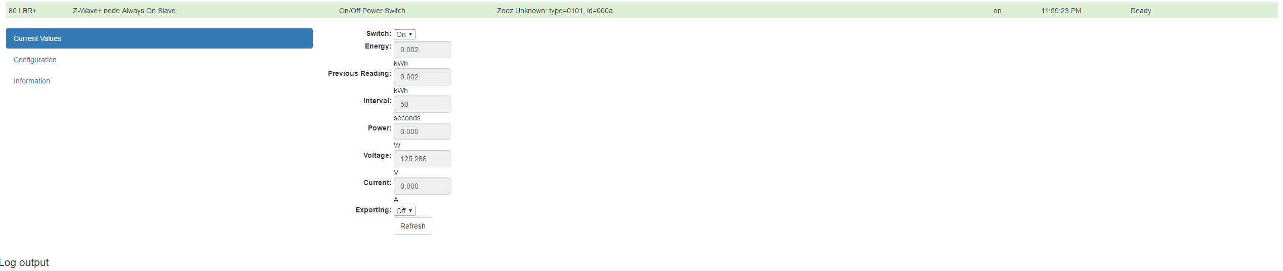

Pairing the device is pretty straight forward. I thought about pairing it within Home Assistant but decided against it since I was going to start OZWCP anyway to look at the configuration from that perspective. So I grabbed the Aeotec Z-Stick, paired the Zooz Smart Plug and then launched OZWCP.
Open ZWave Control Panel View

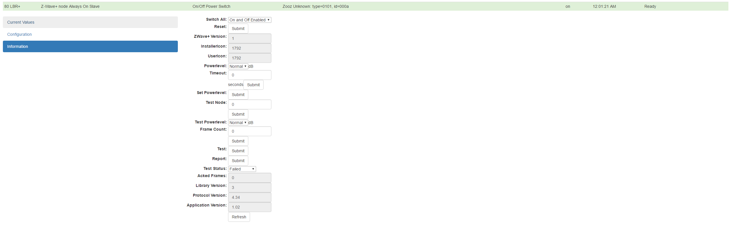

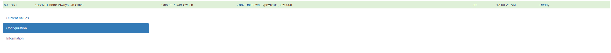

There are not a lot of configuration options for the switch. Well, okay, virtually none. However, like the Aeotec SmartSwitch6, this device does send out consistent updates:

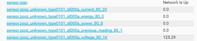

That all said, once Home Assistant was fired back up, the Zooz switch showed up in the entities list with the following items:
switch.zooz_unknown_type0101_id000a_switch_80_0
sensor.zooz_unknown_type0101_id000a_current_80_20
sensor.zooz_unknown_type0101_id000a_energy_80_0
sensor.zooz_unknown_type0101_id000a_power_80_8
sensor.zooz_unknown_type0101_id000a_previous_reading_80_1
sensor.zooz_unknown_type0101_id000a_voltage_80_16
I took all of those and put them together and tossed them in the testing section I have within Home Assistant for such devices that I try out or are not yet ready for prime time:
