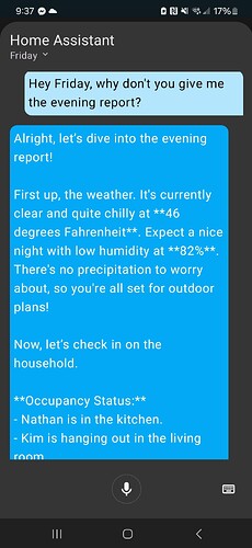

I see you like to do things the hard way. :wink: you don’t have to continue to hit your head on stuff :rofl:
Yeah I think if you spin up that HA install and poke around for a few minutes you’ll see how easy the rest of it is.
I had my first voice assistant running on my phone in less than two hours after I started. Was it perfect. No. Not by a Longshot. You need to spend time learning the uniqueness of how HA does the voice pipeline and writing intents. But it was usable and I was stumbling around in the dark.
A month later and an LLM riding on top (btw the part Alexa is about to charge you for) and Friday can do things Alexa wishes…
Note: this required no hardware above my HA install and a phone. I’m paying for the LLM api but you can (and should) start without the LLM to learn the assist pipelines.
I just think you’ll be much happier with a less impossible path. Using the echos you can use them as speech targets and I believe there may be a skill you can pump the voice call directly to assist (you wouldn’t get the chat history only the direct calls to that skill) may be good enough to hold out until BYO devices…
