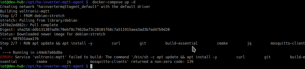

Hey everyone, hoping someone could shed some light on an issue similar to what @riaan199 had earlier, I just can seem to get to get the image to build:
I can’t get any other additional logs on the failed container build all I get is the above error code 139. I’m using an old raspi B+:

yeah I had to use a pi 3 before it started working make sure that the
docker run hello-world
I was unable to get docker to work properly on my old pi
Thanks! Unfortunately hello-world doesn’t run unless I specify the image to pull
docker run armv6l/hello-world
Apparently even though debian images are built for arm they are not guaranteed to work on armv6
Update!! So I finally managed to get this running on the pi 1! :grinning:
