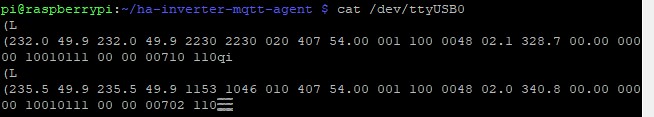

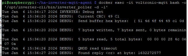

@catalinbordan I’m using your code which works fine with my PowerMaster Inverter but I just replaced the Inverter with a Datouboss 11kW which is RS232/RJ45 based and unfortunately, this doesn’t work anymore. I receive data from RS232 but get this error:
And with cat /dev/ttyUSB0:
Hello, I’m sorry for you, but I don’t know how to help you.
