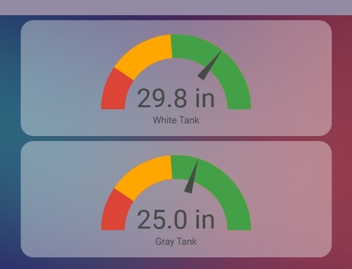

The mopeka sensors are the way to go. Now what we need is an official Propane Tank card and gauge. Maybe even a way to bring it into energy monitoring.
I find the normal gauge cards work quite well.
Unless you’re using a lot of propane, they definitely aren’t precise enough to translate to consumption. I get a good 5% or more of drift/noise from day to day on mine. The water tank sensor was VERY bad in this regard, but I think a lot of that is due to it being a plastic tank, so it flexes quite a bit. Definitely couldn’t rely on it, especially when it started to get low. I’m still reasonably happy with it though, as it gives me much better insight than the stock sensors on the water tank (which is VERY helpful when you’re stretching 50 gallons over a couple weeks).
yes they work but they look like crap. Id like a card with a tank on it at least, something similar to what the mopeka app uses. it would be a better representation when your level is measured in distance.
I forgot that the sensors report in raw distance values; first thing I did was setup a template sensor to get it into a percentage, cause yeah, the distance values aren’t the easiest to glance at and ā€˜know’. :slight_smile:
theyre fine as long as you know the height of your tank. which is also necessary to create your template sensotr
